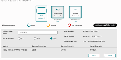

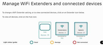

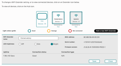

Hi, I have two EE Wifi Extenders (Pro) both of which are showing as being connected to the hub, however one of them is showing as having no devices attached and signal as N/A (2nd picture) whereas the 2nd extender shows as being connected (3rd picture) also on the app on the phone its is showing as no signal.
I have tried to reset it and move it closer, same happens, I have tried to move it further away, same happens.
Any help would be appreciated.

@Andy461 Your pictures have just cleared, showing that the conservatory one is failing to connect on the wireless 6Ghz backhaul and THAT IS needed for the connection to work, is it sitting flashing orange per chance but it is showing connected good which is strange.
The reboot time was also short at just over a minute, takes a little time for the mesh to work itself out...
What is the physical relationship between the Hub and both extenders as the crow flies, distance and walls / doors / glass panels etc.... ie is the Conservatory smart wireless just too far away from the hub to make the 6Ghz signal, and the 6Ghz has a real hard time getting through walls that are brick or foil lined plasterboard, if you had a long Ethernet cable you could quickly test by connecting the two devices together for an Ethernet backhaul....
similar swap the two units over position wise, as you know the upstairs is connecting and working fine...

@JimM11 Thanks for coming back, noted re the 6Ghz connection and no the orange light is not still flashing, both are showing the solid aqua light.
Regarding the reboot, following the step I took i.e. plug in ethernet cable etc I left it for an hour and still no change.
One thing two note, if I unplug the upstairs one and then repair the downstairs (so its the only extender connected) it connects as expected but if I then re power the upstairs one I get the non 6Ghz connection on the upsatirs one.
2 things I think this proves 1) its not faulty equipment (which EE think it is) 2) the one in the conservatory is in the correct position to connect to the hub.
@Andy461 Does seem logical with what you have done, don't see why you would have to do a pairing again though, so with upstairs off and the conservatory saying connected, did any devices also join at that time and connect to the extender. would be good to see the snapshots with the connection to the 6Ghz and what the strength ie the -db thinks the unit is at...
With a Ethernet connected, the unit should have went straight wired backhaul and you would see that in the web manager...
When wired to the Hub devices should have an instant connect and use the Ethernet to shove the data about to the extender.
