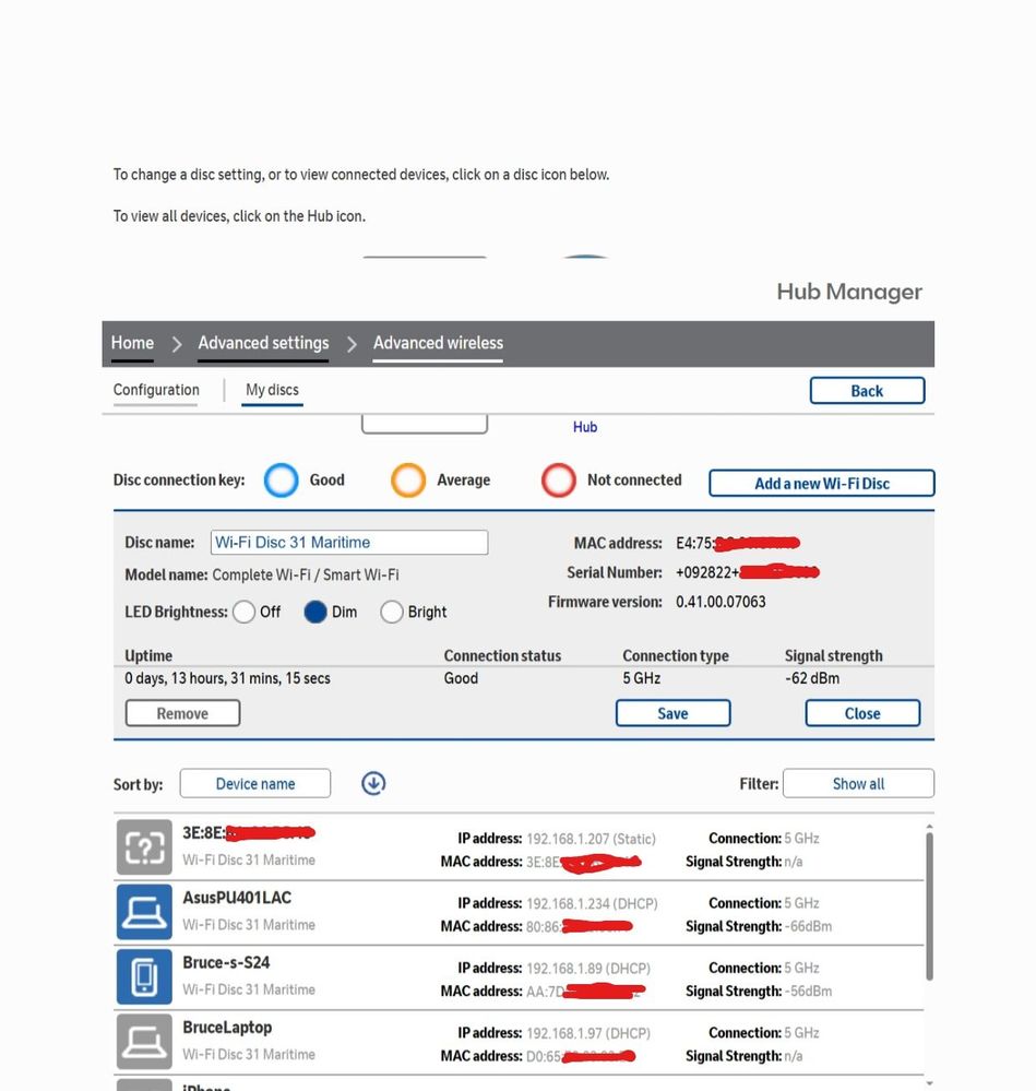

@FlyingCodeMonke do have a look at your Ethernet setting and connections through switches etc, the extenders are showing wireless daisy chain effect unless the software does not report correct, see this picture although of a complete wifi disc connected through to a smarthub 2 were i am at currently working as the owner has a BT system that i had to get working for him....

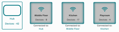

The extenders are definitely connected via Ethernet:

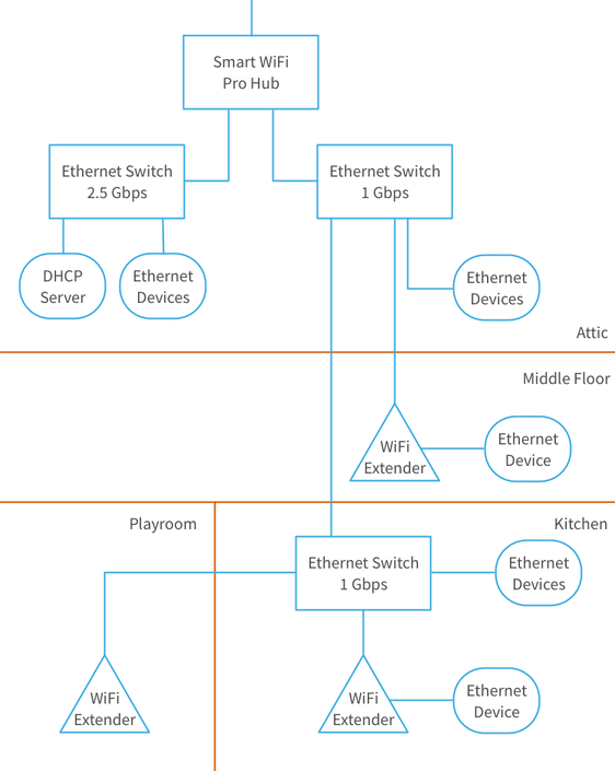

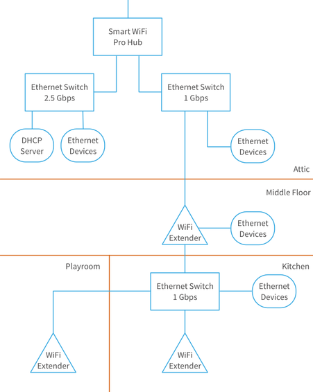

The network layout looks like this. Apologies for the crudeness of the diagram!
@FlyingCodeMonke Middle section is that using more than two connections as you have the additional Ethernet there so surely there is a switch also?

Hi @JimM11 ,
Sorry, I wasn't at home when I drew that diagram and I did it from memory - I should've known better! I've just checked and the middle floor WiFi extender only has one ethernet device connected. The 1Gpbs switch in the kitchen is wired back to the 1Gpbs switch in the attic (it's only the playroom that's got the crazy room-to-room wiring).
I do have one more WiFi Extender that's not currently being used anywhere. I can try incorporating it anywhere in the setup if you think that would help. Last time I tried though, it complained of either being too close or too far away, I could never find a sweet spot for it.
@FlyingCodeMonke Wiring all looks good Ethernet connection wise, do not remember anyone complaining about the DHCP operation on the Pro hub, but you have taken that out off the picture by disabling it and using the PC as the DHCP Server, switch to switch should be fine as passthrough on a non managed switch, would not bother about the additional extender unless you need it, but you will need to ignore messages about too far / too close as that has been reported before when mixed wired / wireless connection's, but do think they work just message is not 100% accurate. Mesh is not easy and devices can get confused when attaching especially when waking up from sleep mode in wireless operation.
@FlyingCodeMonke - thanks for the diagram, speaks a thousand words! 🙂
Clearly more complex than your average setup but I  agree with @JimM11 - it should work.

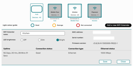

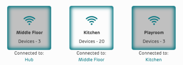

The one thing that perhaps raises an eyebrow for me is the far right extender here: -
Looking at your topology diagram, I'd expect that Playroom extender to report as being backhauled via the Middle Floor, not the Kitchen 🤔
I wonder if you wire things how the Hub Manager thinks you have them if there'll be any change in behaviour i.e. instead of the Playroom extender terminating on the Kitchen switch, is it practical to try wiring it to the Kitchen extender instead? Looks like you'd need to remove the Ethernet device that's currently connected to the Kitchen extender to make room.
