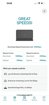

IMG_6532.png see attached.

@PT26 So first one the app test, Max to the EE hub, device is not performing well....

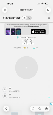

2nd one rocking the boat straight speed test 120Mb/s down as far as the test was concerned nothing to worry about with that one.
Still not sure what your problem is, shared Network two phones doing ie streaming a 4K HD movie each, pulling say each 40Mb/s = 80Mb/s leaving the remainder to be used?
