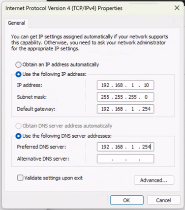

The router shouldn't need an option to delete a DHCP lease. If a device with a matching MAC address requests a lease from the router, then the router should assign the IP that's been previously associated with it. If the router is the only DHCP server on the network then the IP in question wouldn't get assigned to anything else thus no risk of duplicates. The only time I can see this not being the case is if you've manually configured some other transient device on your network with the same IP address within the router's DHCP pool.
What is the behaviour if DHCP is removed from the equation and the PC is configured with an IP both outside of the router's DHCP pool and not used by anything else on your network?
Is the MAC address of your PC's network adapter remaining consistent throughout these problems? Are there any other adapters in the PC (e.g. a WiFi card) and are those connections disabled? What wired adapter are you using, is it integrated or is it a USB dongle or something like that?

Bob, thanks for this.
I had tried every combination you have brought up, I even installed a new Ethernet adapter on the PC !
I managed to 'get lucky' with an IP that worked (DHCP and static) but then would fail after a few minutes or even a day or so.
I have found the answer.
I have a TP Link range extender for a remote camera that was hi-jacking dozens of IP addresses and commandeering whatever address my PC was given/used.
Unfortunately it manifested as a timing related issue. The camera always worked, but the PCs were not connecting *most* of the time. The mac address of the exteder was presenting as a rndomized virtual 26-2F-D0-xx-xx-xx mac.
I had to go from first principles and check all our iphones/tablets and other devices in case they had randomized private settings on, some had, some hadn't, but after switching them all off found the culprit.
It has been a real pain especially as this setup worked on the previous BT Smart Hub.
Set the TPlink to a static IP in the EE Hub and all is now stable.
