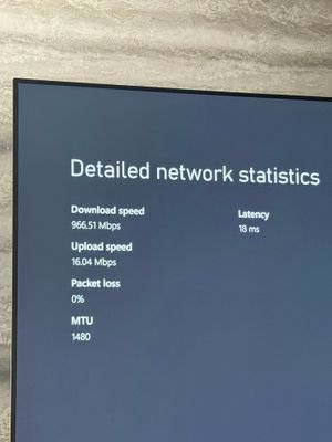

ive had ee fibre installed since July time and not had a issue so far but over the last few weeks I’ve nriiced while doing a speed test on Xbox via Ethernet I’m getting good download speeds typically over 1gb on a 900 line but my upload speeds are only 15/20mbs

They’ve since done a factory reset on the router but I’m still only getting 15mb on upload on Xbox, tried my sons Xbox to isolate a cable issue and that was the same, then tried a brand new cat 7 cable, same again. Different ports. Same again

@Toonsoldier91 You can try then, only thing i would do is unplug the x-box ethernet cable stick a laptop PC on that connection and speed test that cable all the way back to the Router, the fact you are getting the other speed test so high is real strange!
I’ll get my partners laptop out and see what it shows
This is the  result from literally 30 seconds ago on the Xbox.

Will view your posted image when it get's cleared for general viewing!
Ok picture cleared and this is all up to you but you could try this below!
""In summary, for PPPoE connections, setting the MTU to 1492 bytes is advisable to optimize performance and reduce the likelihood of packet fragmentation. If you are experiencing issues with your current MTU settings, consider adjusting it to 1492 for better results.""

@Toonsoldier91 Cannot say that with any definitive answer to power/speed or stability one against the other, signal strength is a device regulated but some work better than others in a like for like situation, you just need to work out the pro's/cons as one against the other, moving third party you have FULL control over what you do with the Router and it is not going to be restricted possibly like the EE one can be! Going to wait to see what your other speed is like, just now it's all pointing to a x-box issue to be sorted out!
