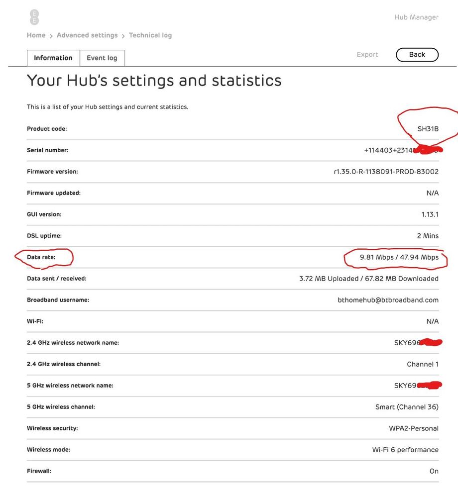

@WMAXH10 Nothing wrong with your tracert's you did, as @XRaySpeX has requested better to get your stst's from the Advanced Status captured and posted, https://192.168.1.254 to get on the web manager.
If you are correct and only 100M from the street cabinet, your sync should be up at the 80Mb/s down - 20Mb/s up unless you have some cable wiring issue home, street to the cabinet etc being that close. Will copy all the tracert's below in a separate for you. If you say which EE/BT hub you are using can show you what would be best, got EE and BT hub captures.
Your OR colleagues may be required to error check your fttc line connection, but there will be some other things you can do once your stat's are looked at.

@WMAXH10 What is your fall back min speed on the line, see the btw and use your address. Have you tried your test socket? It's an OR Openreach problem to fix, BT got nothing to do with this one... Miracle works cost a little extra if you can find a good copper one now, Ex military one you will be good to go, they do know what they are doing.... And sorry from me, thought i had posted and attached the picture ref to look at with the web manager interface, https://192.168.1.254
BT Broadband
Screen to check on your EE Hub.Screen to check on your EE Hub.
