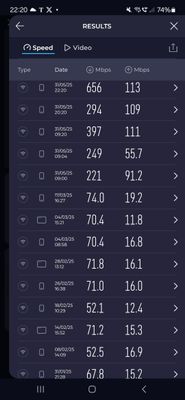

Hi thanks I will try that.
The results using my mobile are
 these results are for today

@ddemolder Take it that you are only using a wireless wi-fi connected device for your speed testing?
Yes just wireless as that is what we use on all devices so is the only metric that counts. It's a big fluctuation in speed.
