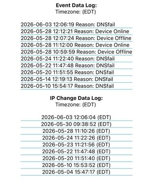

I have a Keep Connect plug which reboots the system when it detects this so that if I am away from home I can still access my home network.
See the logs attached. The last time so raised this with EE they sent an Openreach engineer out to investigate. He said he could see at their end that our port was damaged so he moved my service to a different port.

Your IP address does not change without your broadband connection having dropped. What you're seeing is a symptom of the broadband PPP connection dropping, not the cause. You need to get to the bottom of why the connection is dropping.
This is assuming the log events you've shared are talking about the public IP address assigned to your router and not the local IP address assigned to a device on your network?
As soon as it drops, if I can get to the cupboard quickly enough before the keep connect kicks in the 9 times out of ten there is a red light on the ONT box , so I think the issue is upstream and nothing to do with the router.
