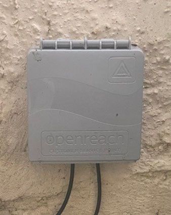

For clarity, below is a picture of my External junction box on the wall outside my house, that has a cable running to the internal ONT as mentioned above.
Junction BoxJunction Box
