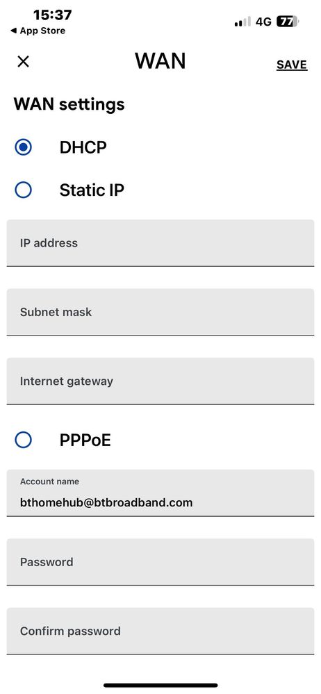

I’m trying to set up my Google Nest Wifi Pro, but I’m having trouble with the settings. It’s asking for some information, and after checking a few articles, I found that the default PPPoE password might be "BT" or empty. However, when I checked my hub’s admin settings, it said, “The password is not displayed for security reasons.”
What I’m hoping to do is remove the EE Smart Router entirely and connect the Google Nest Wifi Pro directly to my Openreach GPON terminal. I really need help with the correct setup with the WAN settings.

Hi! I had a look at that article, but I’d rather connect my Google Nest Wifi Pro directly to the modem and stop using the EE Smart Hub. I’m just not sure how to find the right PPPoE/WAN settings (stuff from the screenshot) to get it working. Any help would be great.

@gossipgirl  Your pic shows your WAN is set for DHCP, which would work without the need for a username and password, proving the DHCP range was different to your EE router.
But for working directly with the ONT the WAN setting needs to be PPOE, with the user name you have. Your Nest may need a password to be set, but EE broadband will work without it’
Just took my EE router out of the chain and connected a Nest WiFi Pro router direct to the ONT - In the Google Home app I factory reset the Nest devices, changed the WAN setting to PPPoE then set the username to bthomehub@btbroadband.com and a password was mandatory so I used BT - worked a charm.  Thanks all.
