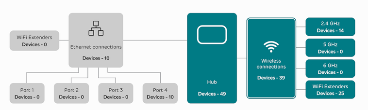

I'd previously stated that I don't have 30+ 2.4GHz WiFi devices but then the obvious dawned on me: I can simply disable the 5GHz and 6GHz radios to force everything across to 2.4GHz (I do have > 30 total WiFi devices).
Results were enlightening and what I saw aligns with your own observations.

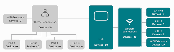

Before I did anything. Single (hardwired) extender and a spread of devices across bands and access points. Everything working: -
After disabling the 2.4 & 5GHz radios. All but one device has reconnected to 2.4GHz however, the load is spread across the hub and extender. From a quick spot check, everything still seems to be working: -

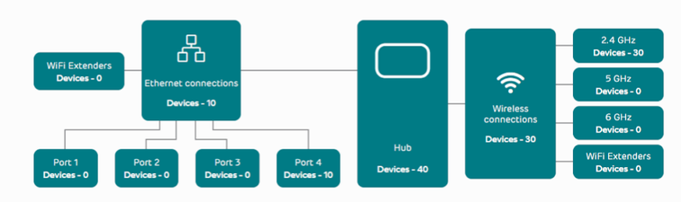

Now for the interesting part. I powered off the extender to force everything across  to the hub. The number of devices that reconnected this time certainly raises an eyebrow 🤨 : -
And spot checking some of them yielded similar observations to what you're reporting. A lot of this sort of stuff: -
I also saw at least a couple of clients disassociate from the WiFi as I was running around toggling WiFi on/off on various devices to try and get Internet resolution working.
To summarise: you're not going mad and there definitely seems to be something awry. Looks to me that it's at an access point level though, so those with large amounts of 2.4GHz devices spread across extenders are unlikely to see it. Would certainly explain why there's not more noise about it as I imagine those with > 30 2.4GHz clients connected to a single hub/extender are going to be few and far between!
