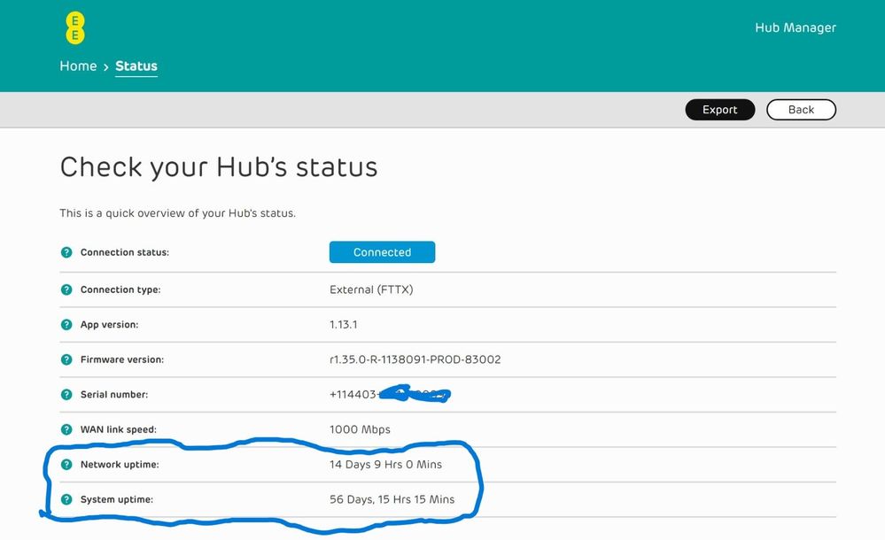

@Hydros Then you have the latest, if the system reboots this evening have a look see, in advanced there is system and network up times, they will let you know what is going on, a wan drop will show as network change and system uptime will be ok as router will NOT HAVE rebooted.

@Hydros Attached a picture to give you the idea where and what to look at, you should be able to see it when cleared for general viewing.
Split times something reset!

Both the Network and System uptime are the same right now, 21 Hrs 52 Mins as of this post. Is there any other info I could provide that might help? I'm going to see if it does the same tonight and tomorrow, and if it does, I'm probably just going to end up trying to stay awake to call support

@Hydros With that time the same then suspect you were FW updated and rebooted at the end off it all! Support ends at 9pm.... 8am they open again it is very hard to say if EE is doing a repeat FW update force, but that has to be the suspect as it is about the only think that will cause the EE Hub to reboot and wipe it all back to the start.....
If it does happen again you know were to look, so give it 10 minutes after it settles back to the Aqua on the hub and then go look at the times!

System Uptime, as long as the EE Hub keeps it's power on it, and does not get reset in anyway the time just rolls on my sample up 56 Day's plus......
Network Uptime, can vary and be changed, few samples OR/EE have a connection problem to your hub, you remove the connection from the EE Hub to the Method that the Broadband is supplied, that will cause the time to be reset, as mine was all done and reset at the same time to monitor the hub, then 14 days up something happened on the connection, nothing else....
