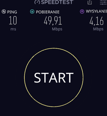

3.Below its current speeds on wifi

@VisHD Looks like you may be having an upload issue with the Line, you may have to get the owner to do a HELP to 66033 for a line test to see if anything gets thrown up to EE, but upload's they care not about so nothing may happen if the download speed hangs in there. You should also run the speed test at various times when issue is not as bad and see if you do get the 50/10Mb/s ever reported back rather than your 50/4 currently. WiFi checking is NOT the way to be testing...

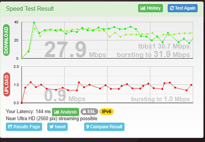

If you would like help with your BB speed or connection issues, please would you carry out the following steps for starters, which will enable us to diagnose the problem and advise you further. Do not restart your router to do these tests:

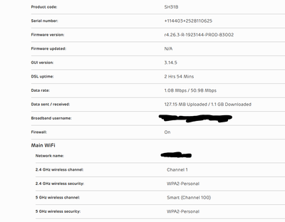

1. Post your full router stats:
  • For a SmartHub: login and go to Advanced Settings > Technical Log > Information. Obscure your names & any numbers in the BB Username & also the SSIDs. Also post the Home > Status page.
  • For a BrightBox: login and go to Advanced Settings > System > DSL Status. Also post 'System Uptime' from top of System Log page.
  • For other routers: login to it according to the label on it as the admin user & navigate looking for its router/connection statistics.
Full router stats are key to any speed & connection issues.
2. Try a speedtest, preferably wired using an Ethernet cable supplied with the router, here http://www.thinkbroadband.com/speedtest.html . Click on the "Results Page" button at the bottom of the graph you first see and then copy to here just the "Link to this result:" link that you see below the next main graph.
2.
1.
 KEEP IN MIND THERE WAS NO ISSUES FEW DAYS AGO , NO CHANGE IN THE HOUSE ALSO SIMILAR THING HAPPEN ONES OR TWICE DURING SOME CHANGES TO WEATHER OR SOME COMPANIES BEEN WOKRING ON SOME LINES IN 2-5 STREETS AREA
