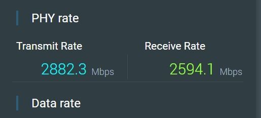

@ben_flugel This is all i have to look at on my mesh to see that it is working as expected.
Asus wi-fi 6 only mesh and speed'sAsus wi-fi 6 only mesh and speed's
