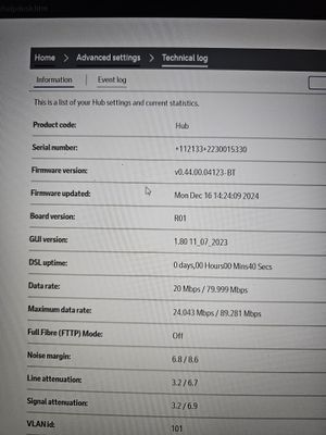

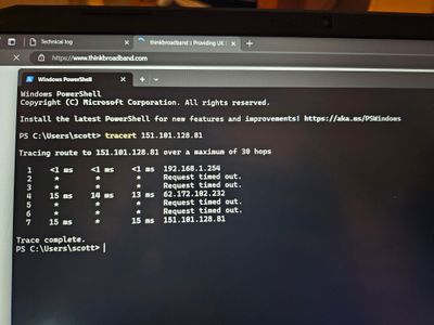

@Scottparnell22    well seeing the results of a speedtest to thinkbroadband I linked earlier would be good, as would tracert to the IP in the earlier post.
Could you also do another post of the Technical log you did earlier.

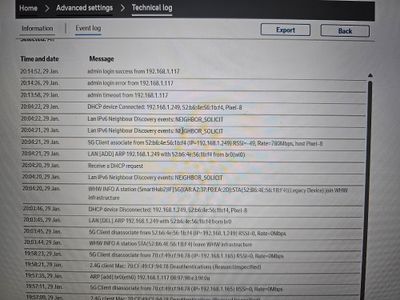

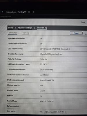

@Scottparnell22    Ah, that is the wrong tab, you have shown the Event Log, and not the Information tab.
You also went back to the bbc, and not tracert 151.101.128.81

Would I be right in thinking you rebooted the router or knocked a cable? Uptime was very low.
