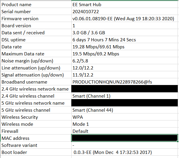

I hope you can help us XRaySpeX, we've been with EE a while and had issues with dropping out with our BrightBox, before we renewed we sought assurances this would be fixed and they sent us their latest Smart Hub - their systems guy tweaked some settings and it appeared to be fine, now after 10 days away it's worse than ever - this dropping does not appear to show on the Smart Hub lights (unless we don't see it happen) but it does show on the Alexa's, buffering on the TV, disconnections when I'm working from home, etc - hope this reveals something for us...
Link to wired speedtest:  https://www.thinkbroadband.com/speedtest/1662191023640759255

@Bsmart : All your results are fine & show no sign of issues.

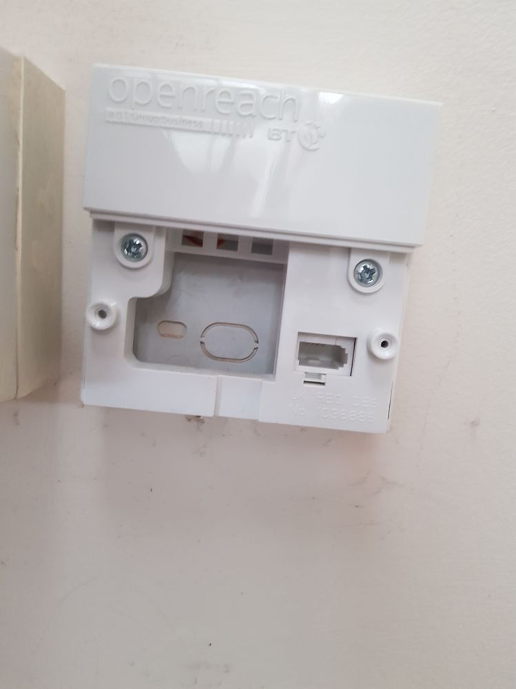

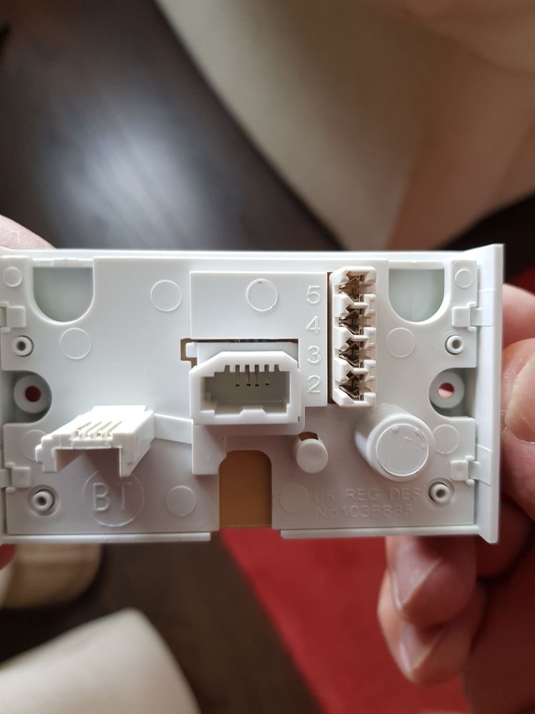

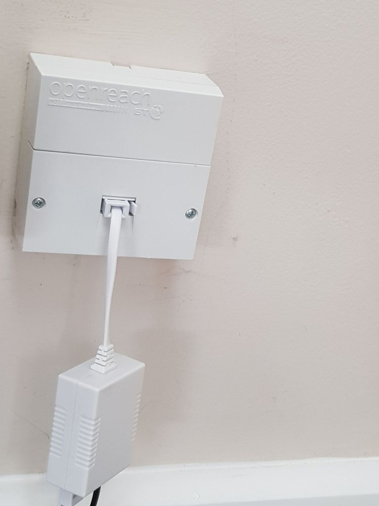

  1. If there is no test socket, that is not a master socket (not recommended) & there wouldn't be a split faceplate. Post images of it outside & in so we can ID it.
  2. Aren't there times in the log so we can assess the frequency?
Here's the socket (this is the only one we have in the house):
20220904_120820 - socket shot 1.jpg20220904_121133 - socket shot 2.jpg20220904_121145 - socket shot 3.jpg

There's the test socket on the back box on R as you look at it.
