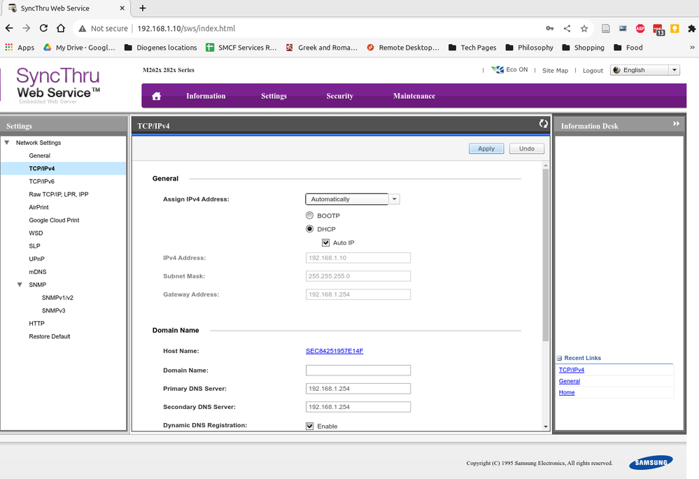

Just to check & clarify would you post an image of the printer's IP Configuration (TCP/IPv4) settings when you want the router's DHCP to assign an IP to it?

03-01-2024 08:22 AM
Here you go. Because the printer has no display panel, and only 4 buttons, this is what one has to use to configure it, which is a pest, because in order to access this control panel, the printer has to have an IP address! So, I'm forever switching the ethernet cables about in order to connect directly to the printer and use whatever IP address (typically 169.254...) it has given itself. Anyway, these are the settings that I think should be correct: Auto + DHCP + AutoIP.
(The greyed out figures are what I'd previously set it to, in order yet again to try and see if it could force the router to recognise a static IP set at the printer (client) end. No joy there, as usual.)
Is it possible that the router is not getting the broadcast messages sent by the printer as the first stage in the DHCP process? If not, why not? ....

03-01-2024 12:06 PM
What happens if you take off Auto IP? It's already set as Automatically DHCP.
