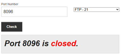

Followed the User Guide and a YouTube video but CANNOT get port forwarding to work.
https://youtu.be/LJ3X3dD3DFU?t=648
I can 100% access those devices via my LAN on those ports and they work 100%
Cannot access them via my WAN IP address on those ports.
PortChecker shows the ports are closed.
However when I put the server into a DMZ (DO NOT RECOMMEND) I can then access the ports from my WAN which must mean the Router/Firewall is not working correctly.
Please can someone recommend a fix for me.

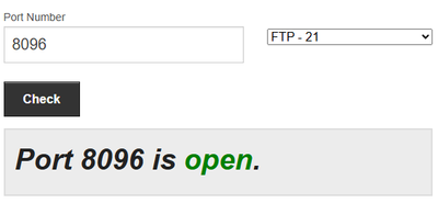

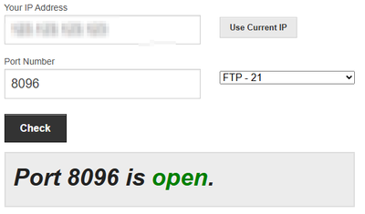

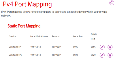

As I only had this installed today I was able to reconnect back to my old Vodafone broadband that is still up but not sure how long for.
And as you can see below, VERY SIMPLE port mapping and my Jellyfin server works 100% from my WAN IP
BTW its only TCP that needs to be open so ignore the TCP/UDP
Why doesn't it work for the EE Router with the same configuration of port forwarding.
