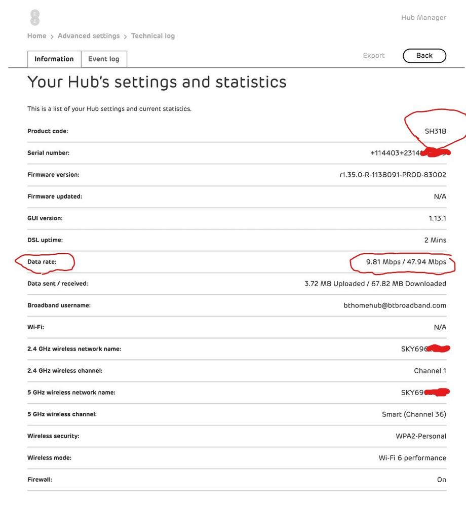

@Polestar2 What did you have with sky? There is also the new 10 day training period for the FTTC copper connection if that is what you have, easy way is the hub is still connected from the DSL socket on the back off the EE Hub to an Openreach Master phone socket. You do not want to be resetting the Hub too many times a the start off the changeover from the sky version. Grabbed an old log file from way back in the day and marked what is required for you to look at, https://192.168.1.254 and the Advanced side logs.
SH31B connected FTTC on a copper connection to the home.SH31B connected FTTC on a copper connection to the home.
