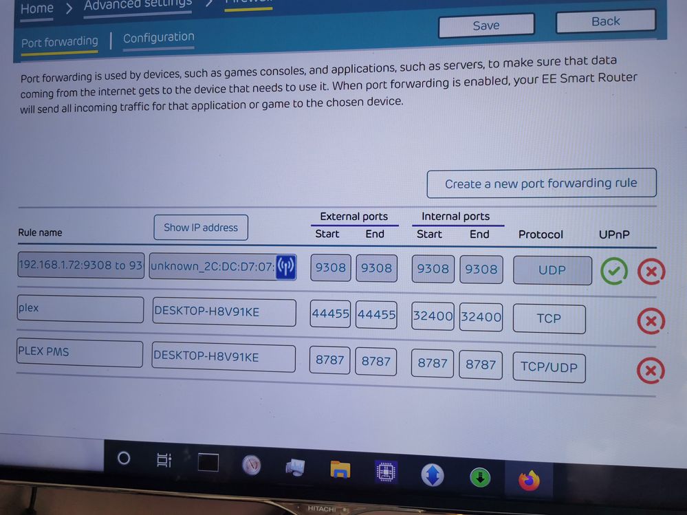

I just wanted to check with you guys should UPnP be ON or OFF as it stands I have left it ON though it isn't ticked like other devices that use it. Does it matter?? If UPnP is ON should it not automatically resolve changing public IP addresses?
Thank again
