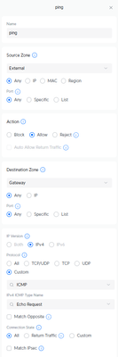

I'd monitor it using a BQM (you'll have to enable ICMP to your WAN though)
I recommend https://www.thinkbroadband.com/broadband/monitoring/quality
If you're using the latest 10.x version of Unifi Network, go to :
https://192.168.1.1/network/default/settings/policy-table
and do the following:
Create new policy (firewall)
name BQM ping
Source Zone
External
Any
Port Any
Action Allow
Destination Zone
Gateway
Any
Port Any
IP Version
IPv4
Protocol
Custom
ICMP
Echo Request
Connection state
All
Schedule
Always
