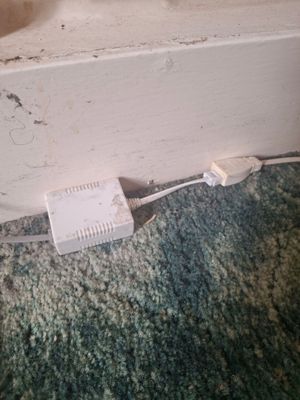

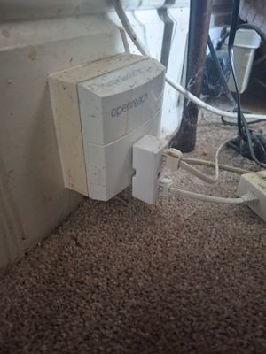

p.s this is reason there's 2 micro filters because when it comes upstairs it looks like this  so need to attach a filter so it all fits. Is this ok
Where's 2 microfilters? What are those boxes?
What's to the L of that image & what's to the R?
What are the 4 plugs that go into those 2 boxes? See below:
BT Phone plug goes into phone socketBT Phone plug goes into phone socketRJ45 Ethernet plugRJ45 Ethernet plugRJ11 DSL plug goes into filterRJ11 DSL plug goes into filter
@gazmix_1973 As you are doing the transition from your older ADSL to a newer and Faster VDSL your wiring as it is stays exactly the same, the EE Smart Hub 6+ connects on the RJ11 cable upstairs via your filter into the RJ11 connection on the EE Hub, think it is marked as DSL if i remember correctly, the double splitter you have down stairs and the Filter with the Landline Phone on it you can remove so the ONLY connection to the Master OR Phone socket will be the one that heads upstairs to the EE Hub connection. Your phone will plug into the DVA downstairs once you pair the DVA to the Hub in the DECT frequency range. Will Link that so watch the video to see how it is done.

@XRaySpeX the front room pic is a splitter I think, one goes to the phone and other to the router upstairs, the other pic is where the cable comes through the floorboards, goes through filter then in to the router.
