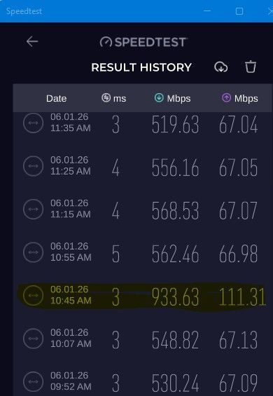

TBH I don't need 900 either! But like you it was a much better deal than the 300 that I was on,  it is definitely a PC issue, the only thing I can think of is that the PC wasn't W11 compatible but you can override the checks which is what I did, it's not a big deal but it annoys me, I'm retired now but spent most of my working life troubleshooting IT systems and old habits won't go away!  What is really irritating is in the screenshot and it did it just the once after deleting the network device and re-installing it. Thinking I'd fixed it I rebooted and was back to square 1.

Disks aren't used when running an Oookla network speed test so that's a red herring.  Yes I did override the hardware checks to install W11 and I said in another reply that possibly could be the issue although  I did once get the full expected speed on a speed check.
