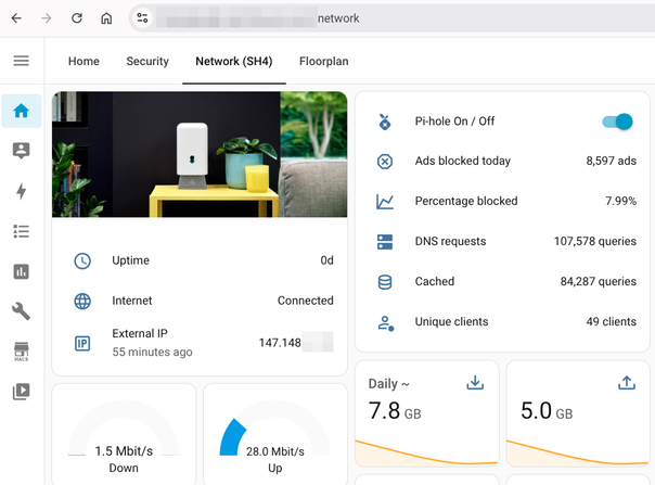

@madmull2025 - if it's any reassurance, I have a Home Assistant install hooked up to my Pro and it's working fine, along with all of my integrations etc.
The PI5 running home assistant is connected to internet via ethernet just fine. My PC is then ethernet into the EE range extender and working fine but just wont open home assistant web address.
I think this ^ might be something to do with it. I can't speak for the lack of inverter data but I've noticed oddities in the past trying to access hosted services on my network from a device that's connected to a Pro Extender. It doesn't affect local access though via the IP address/local hostname i.e. homeassistant.local:8123 works OK for me.
What I've found is that NAT loopback doesn't always work from the extender. This means if I try accessing a server/service on my network using it's publicly accessible IP or hostname e.g. http://myserver.tld or http://<my_broadband_ip_address> then it times out. I don't have the same problem if I use the internal IP of the server. If I then take the connecting device and connect it to the hub, rather than the extender - it works. I've posted about this previously but am struggling to find the thread.
Hoping that gives you some clues/stuff to work with. The loopback issue will be something EE need to fix in firmware, I imagine.
