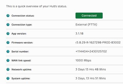

on 20-06-2026 11:10 AM
Looks like the latest firmware might have helped address this issue if there's anybody that fancies confirming?
- Fix - Microsoft Teams/UDP issues in some situations
on 20-06-2026 11:43 AM
Hi @bobpullen
I just checked my FW and it's over 9 months old. I can't see a way to force and update:
I've got a smart hub 6 pro
on 20-06-2026 11:56 AM
on 20-06-2026 12:08 PM
I did mean plus. good spot.
Will wait and see
Thank you
