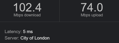

Yes you still have the FF900 gigabit connection and the BT Smarthub2 and it's mesh in a good day will do 500Mb/s wireless tops! Your 100/70 should be no issue for a teams speed connection!

Agree that Teams is okay. Video is pixelated though.
