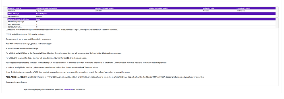

  2. What does BT Wholesale Broadband Availability Checker estimate for your phone number? Post just the whole table and the line above it, blanking out your phone number. If it doesn't recognise your phone number or you don't have one, use the Address Checker, not the Postcode Checker.
Ok maybe i could have phrased it better. He basically said there's currently no active service on my line and looking at my account he could see there was previously a service which had been transferred out.
XRaySpeX
EE Community Star
EE Community Star
You can only get Full Fibre there. However there is no record of it ever being at that addy. If it had, where it says "FTTP Available" would say "ONT exists". Do you still have an ONT on the inside of an exterior wall? Once installed it should never be removed.
