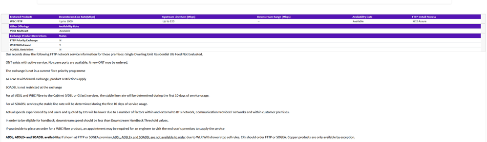

Glad it's sorted! What does BT Wholesale Broadband Availability Checker say now about FTTP & the ONT at your premises?

Ah, there! It now says "ONT exists" as it should do.
