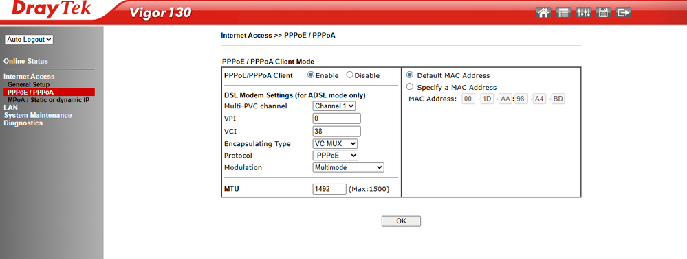

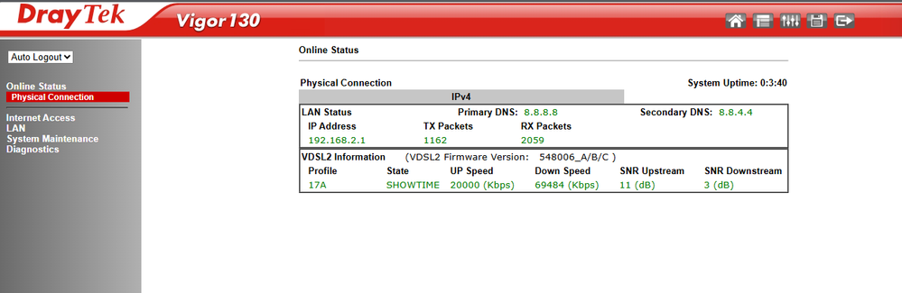

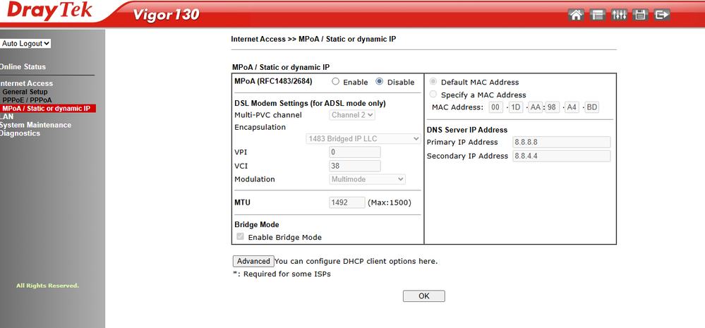

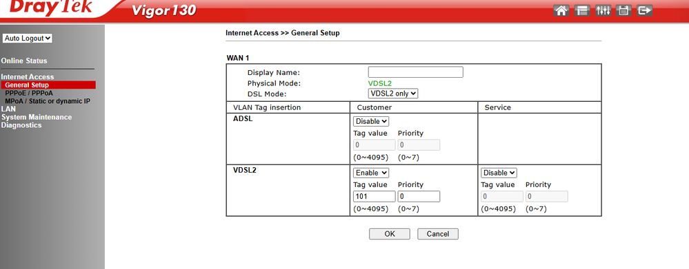

I am still trying with this. Here are my screen shots of the modem, can anyone see anything wrong. On the synology I have tried every combination of username and password including  [email protected]/BT. It still feels like a settings somewhere I have overlooked.

Try on 1st screen: WAN1 > Service > Enable > Tag Value = 101.

Thank you again for your replies @XRaySpeX .
Unfortunately this did not seem to make any difference when I enabled 'service' as you suggest.
I have had to reset the modem a few times during this process when I have not been able to get into the webpage, I am hoping I put the correct settings back in each time. It does look to connect, the modem that is, the dsl light is solid green. The synology router looks to be working too, nothing obviously wrong, just no actual connection. Is there any chance these username/password is wrong or could there be another? I have read that you don't actually even need one as they are not checked, I am not sure about this, but the synology defintely wants a username as a minimum.
I have two routers, and I have tried both with the same problem. So if we rule out the router as the issue. I wonder if its worth looking at the modem, and would it be worth buying a cheap 2nd hand modem and swapping it out?? Are there any good 2nd hand choices perhaps?

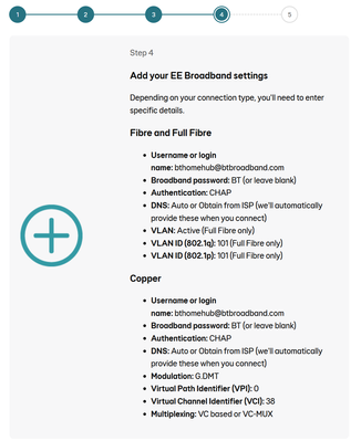

The username & pwd given in that article are those that are required by the router.
