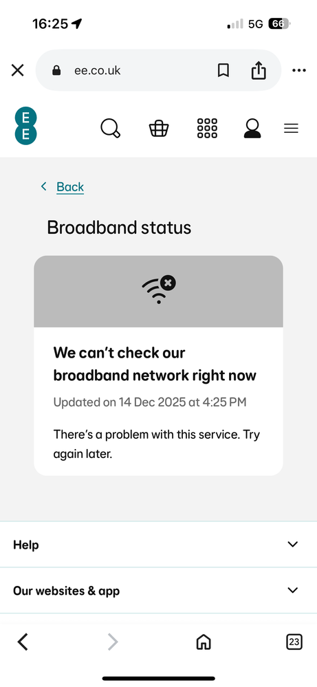

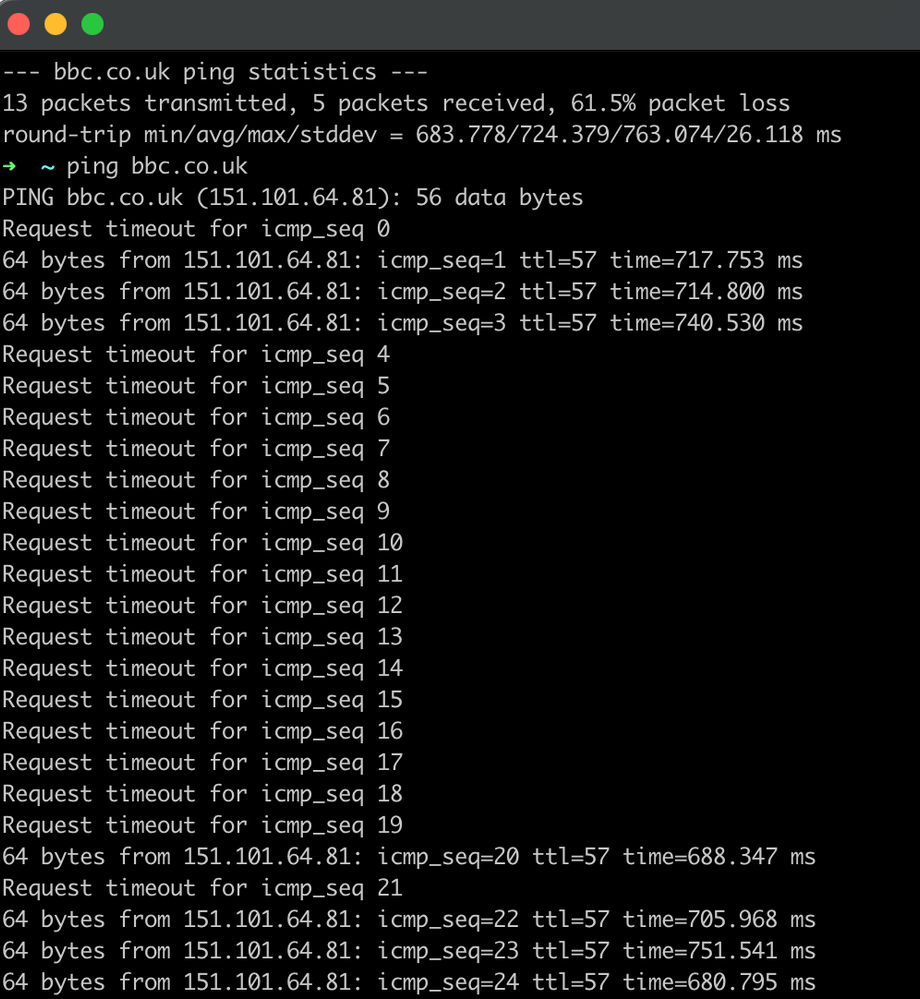

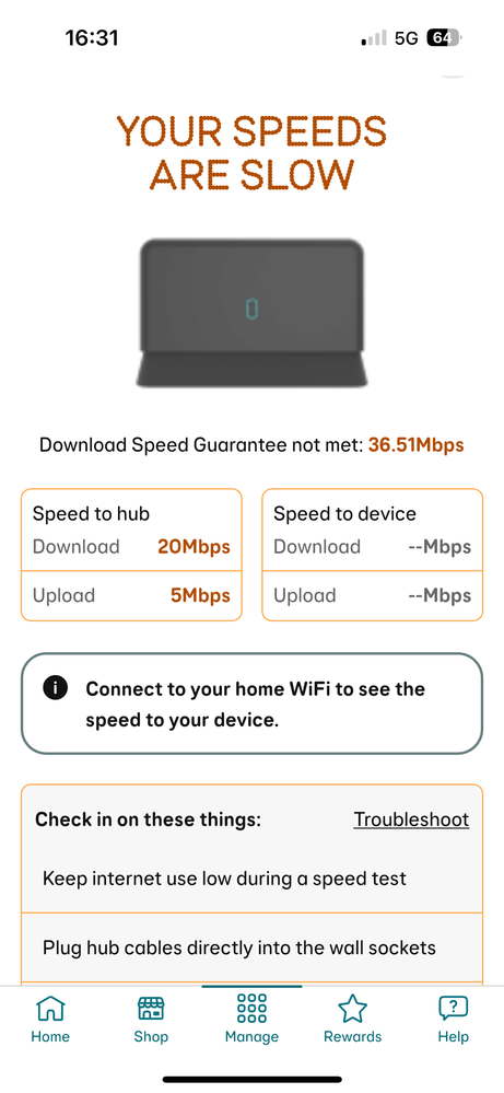

gallaghp
Investigator
Investigator
Sorry for taking so long to reply. I've indeed contacted them - over the phone and through a visit from an EE engineer and later an Open Reach engineer.  They've tried a variety of solutions but none seem to correct the issue.
Over the phone they could see there was a problem but not what it was. They arranged the in-home visit. He called me up, asked what the problem was over the phone and confidently diagnosed it as "Netflix". I told him that it wasn't, we didn't have Netflix etc....  He  showed up and told me that my hub was turned off - I had to explain that I'd turned off the light (it was distracting my dog at night); and all he did was (1) a speed test via fastnet (2) swapped out the microfilter and .... did a speed test via fastnet (3) plugged in his own BT hub that he brought.... and did a speed test via fastnet.
I showed him the output of some  traceroute, networkQuality (I use a Mac) & ping commands. I should point out that I had to explain what these commands did. He was bamboozled and admitted it wasn't something he could fix and warned me that if he marked it fixed, they would send an engineer out again (him) so he left notes.
Long story short - the problem persisted, gradually getting worse, and after going around the houses an Open Reach engineer came out. He immediately believed me, understood what the issue was and confirmed he could see the problematic behaviour with his tools. He replaced the "split" coming into the house and checked the problem from the local exchange, and said it was fixed. It seemed ok but my wife later reported some anecdotal behaviour that sounded like the old problems.
That was 3 days ago. We had an outage this evening and have had to go through the process again from start.  I'm incredibly disappointed.  The only positive being that at least it's relatively quick to get through to someone, even if it's not helpful - turn it on and off again; but they at least confirmed it wasn't a local outage in my area.
Any ideas or suggestions are welcome. Thanks in advance
ps. I've attached some images - of my attempts to use the EE app to sort it out (using 5G not wifi ) and then of some ping output (cropped to avoid personal info); as much to prove I'm not lying as evidence of the problem .
