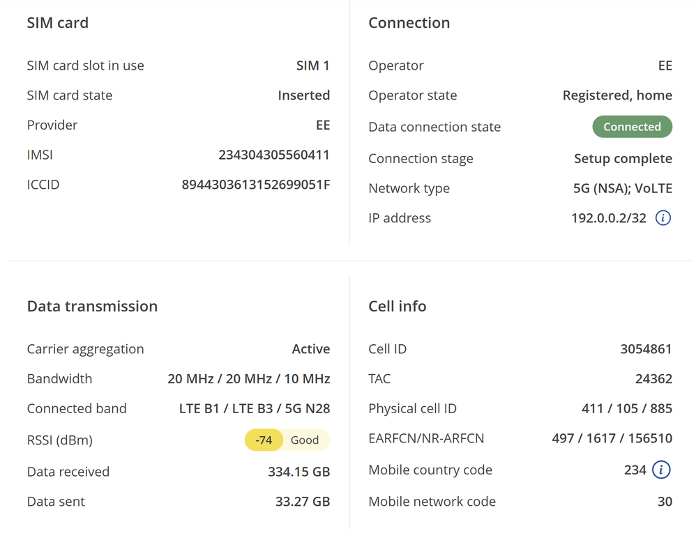

Out of exasperation, I bought a Teltonika RUTX50 in case my router was on the blink (even though the phones are showing the same symptom). I have replaced my EE-supplied mobile broadband router with the Teltonkia device, and I get the same issue.
I then sought to rule out the external antenna by using the antennas supplied with the RUTX50. The signal is "Good" according to the RUTX50 UI - see screenshot below. I still get the same issue.
