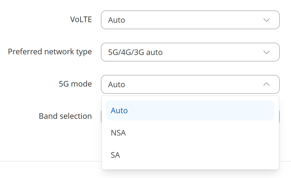

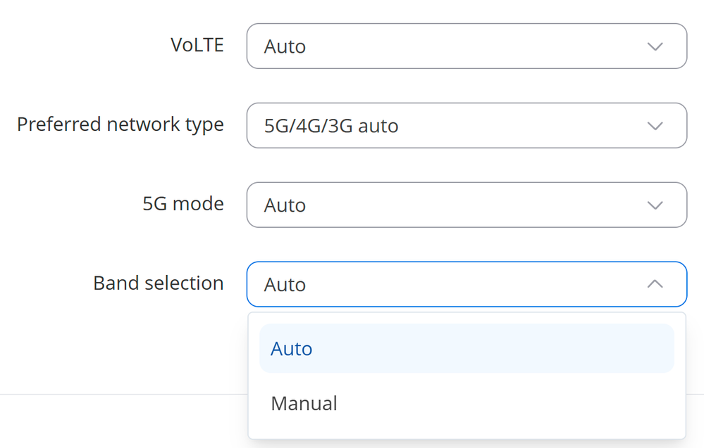

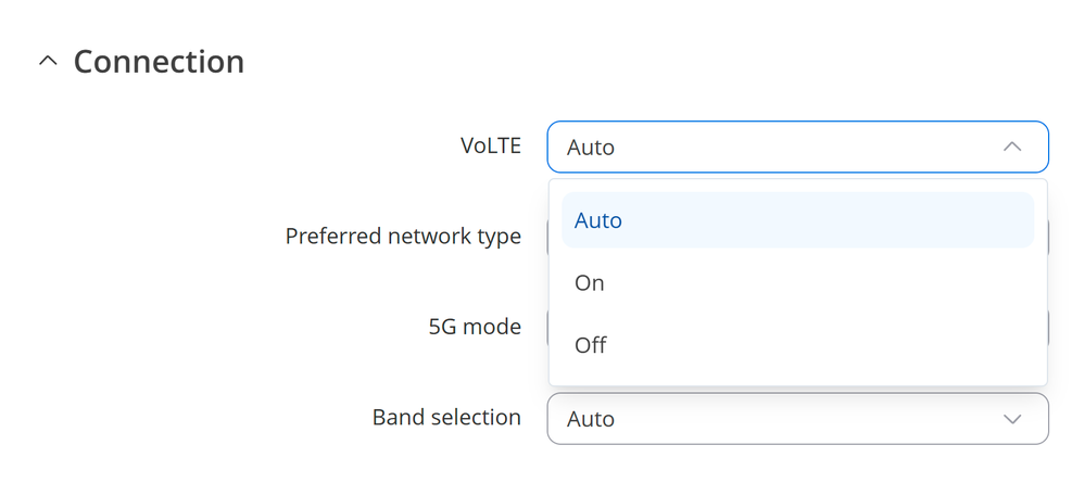

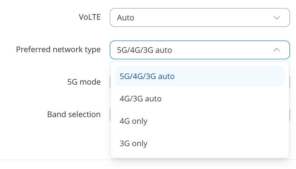

I have the following options available to me in the RUTX50 admin UI. The option in pale blue is what's currently selected.
VoLTE: Screenshot 2025-05-29 182912.pngPreferred network type:
5G mode:
Band selection:

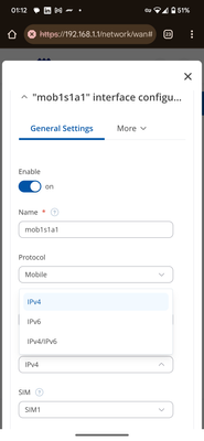

As of the last hour or so, I appear to have been able to bodge my connection into working by disabling IPv6 (on the mobile side of the router, as opposed to the local side of the router). Will EE catch that this is the case and recommend it as a potential workaround to affect users or will they continue to tell people that the service status indicates that there are no issues? I think we all know the answer to that question...
ArmitageShanks
Established Contributor
Above is what the setting looks like on my Teltonika RUTX50 router. Since switching from"IPv4/IPv6" to "IPv4" for the "PDP type" on my device, things seem to have become stable. I'm not convinced the bandwidth is back to where it was a week or so ago but it least the unreliability and intermittent connectivity is seemingly worked around for now.
