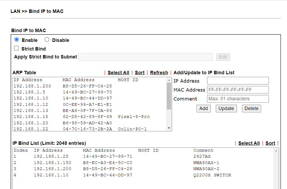

If you have a Draytek router then it is possible to give the NVR a fixed IP address. To be able to do this you will need the Mac address of the NVR, which will hopefully be on the label at the back, if not then you can temporarily turn of the Wi-Fi and just leave a PC plugged into the router and the NVR.
The Draytek will show Mac codes of items connected , as below. Simply give the NVR a fixed IP address and that should work. There is a but here though , you appear to be using 2 routers ?, you will have double NAT issues and if that is the case  this could be the biggest issue
