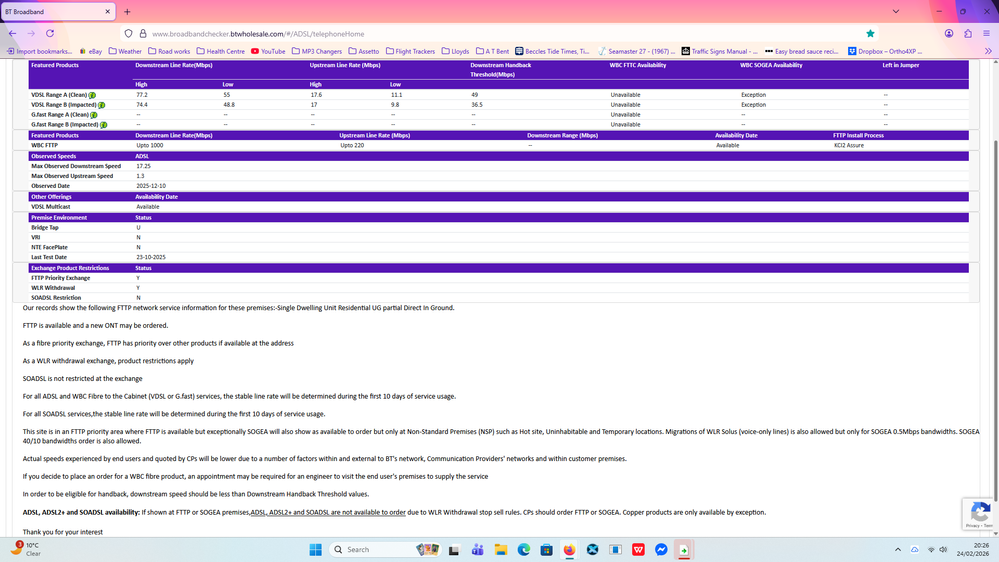

What does BT Wholesale Broadband Availability Checker estimate for your landline no.? Post the whole table, the text below it and the line above it, blanking out your landline no.

You are currently on 17 Meg ADSL but you could switch to Full Fibre (FTTP), either taking your landline with you as DV or leaving it with BT to go "DV from exchange" as I did.
One must ask about your current situation. Why have you left your landline separate with BT rather than taking it across to EE with your ADSL BB?
