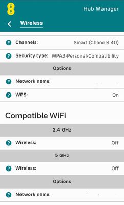

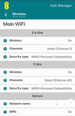

I beleive the problem may be the router settings and all the stuff about 2.4ghz or 5ghz or compatible WiFi etc. See photos.
So my questions is, has anyone ran into a similar problem and can you tell me the fix that doesn't require resetting the hub or devices everytime?

Try setting up Compatible WiFi on the router under Advanced > Wireless Settings & connect your problematic 2.4 GHz devices to that.

Just had a look. It seems most of the devices are already connected on the 2.4ghz. And they're still giving issues. 😔

@UniqNo Your security type, the devices you have do not like or are not stable with that level!

Your devices may be connected to the 2.4 GHz band on the Main network but with a unsuitable Security Type, WPA3. By connecting them to the 2.4 GHz band on the Compatible network they will take on a more suitable Security Type, WPA2.

@UniqNo Your devices will all be WPA2-PSK and do just not like the WPA3-T compatibility mode off operation, so with the EE Hub you have if the primary wifi cannot be adjusted and i think not now then go as @XRaySpeX say's and setup the other mode off operation and with whatever bands you need as an either or situation!
So i did this and now nothing is connecting.

@UniqNo When you setup the Compatible mode you then set the devices involved to connect to that, is this what you did?
You have to enable comp mode, you will now see another name ie EE-????-Comp i think or similar have linked the help!
Set up and use Compatible WiFi | Broadband Help | EE
Just enabling that mode should NOT stop all the devices that were connected before from working, what EE Hub are you using, see the link to the types below!
