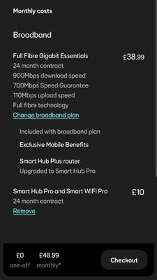

Just a small correction on this,
The Smart Wifi Pro addon is £10pm and provides the WiFi 7 Smart Hub Pro and Smart WiFi Pro extenders.
The £7pm option is just Smart WiFi Plus, providing the extenders for the WiFi 6 Smart Hub Plus.
@hostler see the package below:
