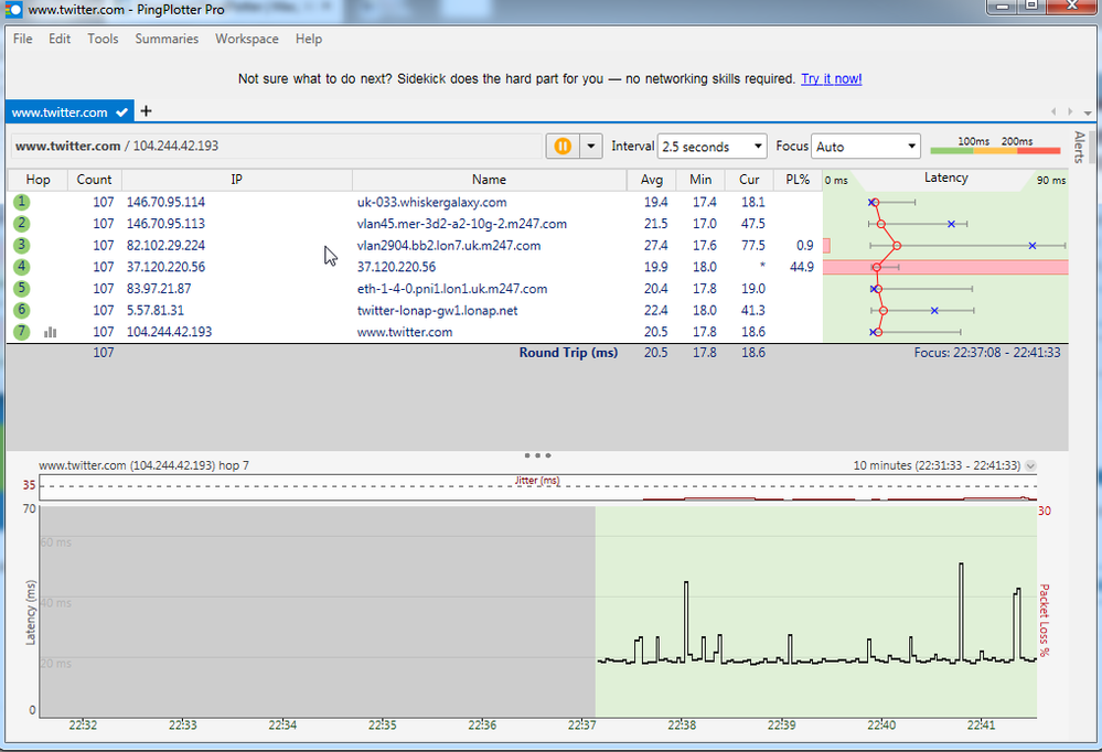

The best way to atempt to show your problem is to use ping plotter (free edition) available HERE.
It will show where the problem is occuring.
The screenshot below shows 0% packet loss. When reading the plot always start from the destination and work backwards. All the screenshot shows is 2 routers busy doing their job and treating ICMP (ping) requests as low priority and not responding in the required time. The packets were still sent to the destination.

That ping test you post is useless. It doesn't show where the delays are occurring & whether it's to be expected to have delays at such servers.
13-02-2023 11:09 PM - edited 13-02-2023 11:10 PM
It shows no delay because there isn't any, I'm on a VM connection so the RTT is the norm. It would show packet loss if there was any which the OP is saying is the problem and it would be able to be traced back all through the route.

@pip11 so not really a lot of help when the OP's issue is a line problem reducing speed from 18Mbps to 500kbps - ping plots don't help so much that way.
on 13-02-2023 11:27 PM
Yes, I'd rather be looking at the characteristics of the line, Ping plotting is a blind alley.
