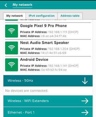

Hi, thanks for responding so quickly. I tried that with no luck. Weirdly I have noticed before that not one device connects to the 5GHz band as in attached
not sure if that is relevant though!

If you look on the router manager do you see any indication that it is on any off the wireless bands? You picture is not cleared yet so cannot view it.

Can't see it on any other band, my 5GHz band never has any connections to it strangely
