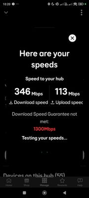

Actual status of "SPEED TO THE HUB" which both myself and EE Guide on 150 can see is like this:

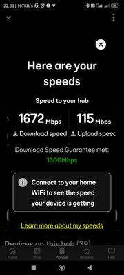

 whilst last 1 1/2 month was faultless like this:
nothing changed whatsoever, only EE Smart Hub Plus (2023) SH31B upgraded FW overnight...

My connection is back at normal speeds... speed to the HUB is 1692 Mbps at a moment, a few hours (approx 10) after we spoke and pushed settings through the network...
