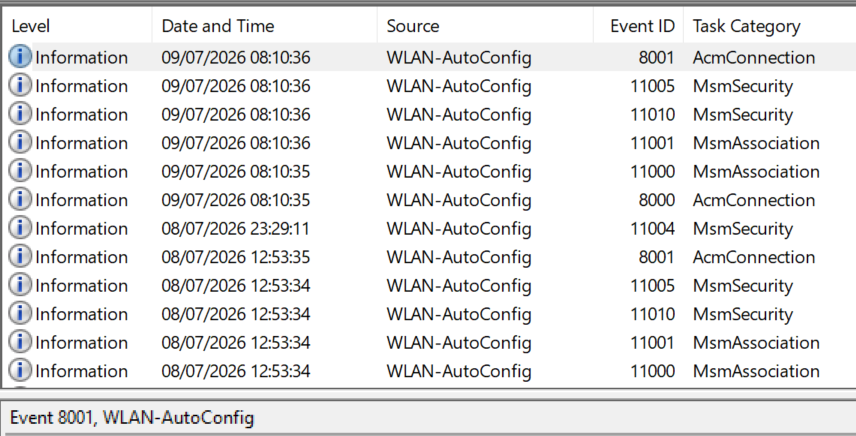

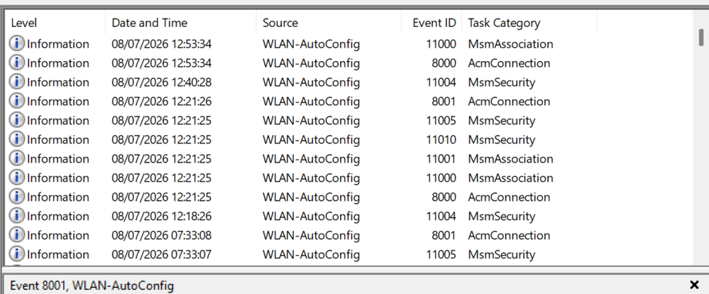

@Cliff_G If you do think it's the EE Hub although it's a complete pain to do with no Backup facility, then you may just have to bite the bullet and Factory Reset the sucker, that should in theory reset all the values in the EE Hub! Just cross everything and touch hold as much wood as you can if deciding that's the way to go? Grabbed a couple off mine showing a few time start's for you when they get approved for viewing. Going to reset the log and do a restart also. Jim
Today's start was at 8.10am
Yesterday's may have been a restart as well.

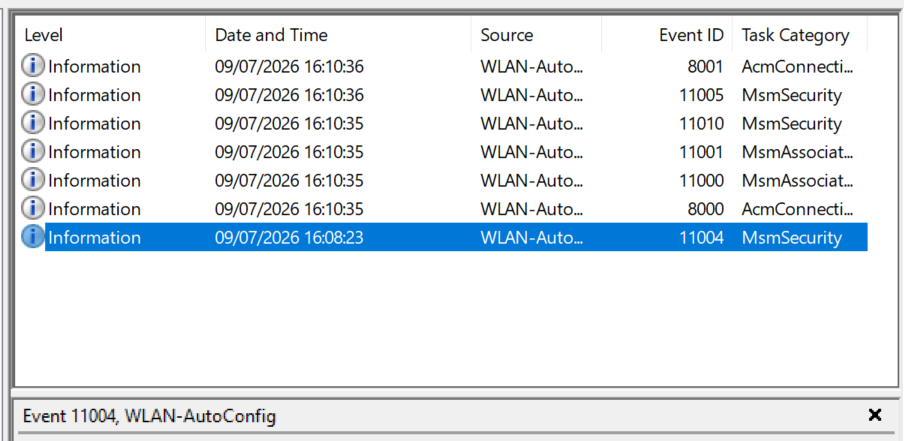

@Cliff_G Straight clear the log, shutdown the computer and a restart at 16:10.00PM..#
Shutdown Restart and what is logged.

I can't see your 5:03 message image, just a yellow triangle. ?

@Cliff_G Once approved you will see it, also below the seven steps that the interface produces below from that once cleared from bottom to the top steps. Bold highlights the section breaks ..... It's cleared now so you should be able to see it.
