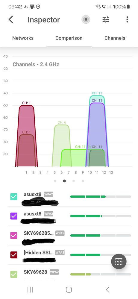

The Netspot app you downloaded will show you the 2.4Ghz band and what the profile is like, channels connected and used.
Snapped my network for you to look at, channel 11 is naughty neighbour using a 40 wide TP-Link device, but he is not clashing so do not have to rag on him.

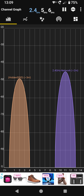

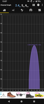

@Huggons1 Why all the pictures, and why is your network jumping about so much if the pictures are anything too go by?

All of these pictures show my network on channel 11. Added extra ones to show other networks that appear too

But they illustrate nowt about it jumping away from Channel 6, which is the issue.
