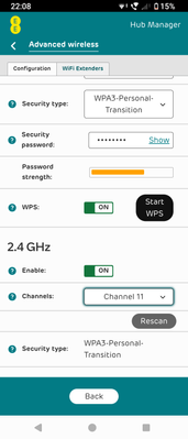

I set my 2.4 GHz to a fixed channel 6 and saved. The setting doesn't hold and changes to channel 11. I have factory reset the router and the firmware is up to date.

Setting 2.4 GHz to a fixed channel 6 and saved. The setting doesn't hold and changes to channel 11. I have factory reset the router and the firmware is up to date.

@Huggons1 Post a screen capture of your advanced wireless settings page, hide you ssid.

Now updated to new firmware, but same issue. Manufacturer of my heating controls, wants me to use the fixed channel 6
Firmware version:
r2.64.3-R-1213091-PROD-1
App version: 2.34.2
