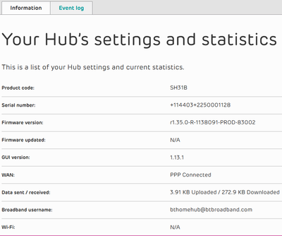

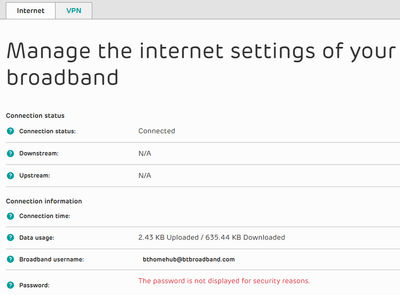

This old link takes you to BT screen captures a few months ago.
BT Smarthub2 on a FTTC 40/10 split. - The EE Community
