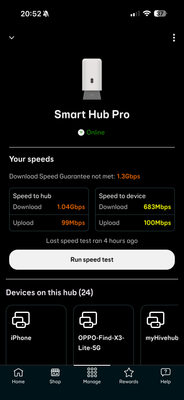

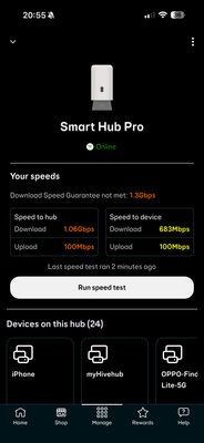

Just got EE broadband activated today moving from Zen. On Zen was getting the full 1.6gbps but now Ive moved to EE Im getting 1.03gbps - below the 1.3gbps speed guarantee... Initially I was getting below 1gbps but realised the Ethernet EE supplies is Cat 5e so technically not able to handle over 1gbps and once changed to an Ethernet cable I have from an Eero it went above... but cant seem to figure out the speed drop...

@RobbieBark - how are you measuring the speed? Is it using the speed test from within the app? If not, what does that tell you? It’s useful as it tests the speed to you hub, removing anything local from the equation.
Yeah, it’s the speed test on the app

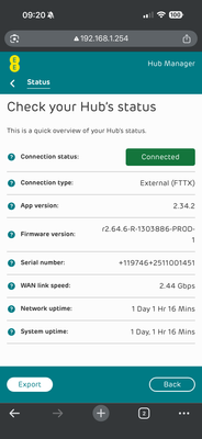

@RobbieBark - If you log into the Hub Manager at http://192.168.1.254 and navigate to 'Status' (you'll need to enter the Hub admin password), what does the 'WAN link speed' report?
This is what it’s showing:
@RobbieBark You are nearly there, at least Speed has synced and only sight FW update now to the latest that can happen anytime overnight.
FW: r2.64.7-R-1303938-PROD-1 and the gui is at App version 2.34.2. 07/02/2025
