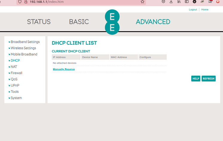

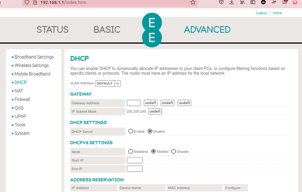

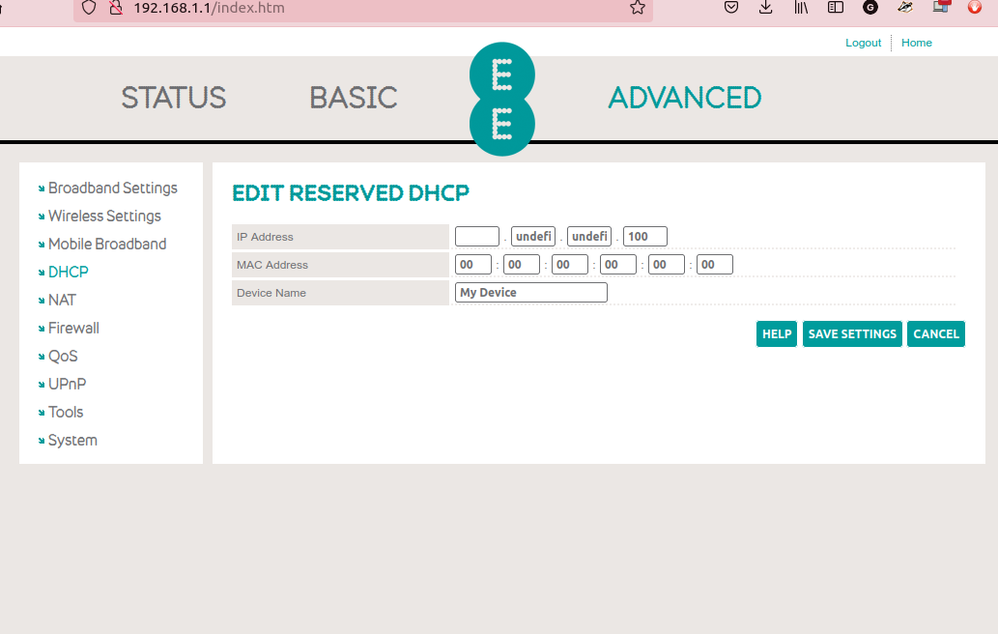

I want to reserve some dhcp addresses on the lan for specific controllers. I know how to do it but my router does not permit it. The fields into which I should type the current ip won't accept entries (except the last field). It accepts a mac address but then won't save it due to lack of the ip address.

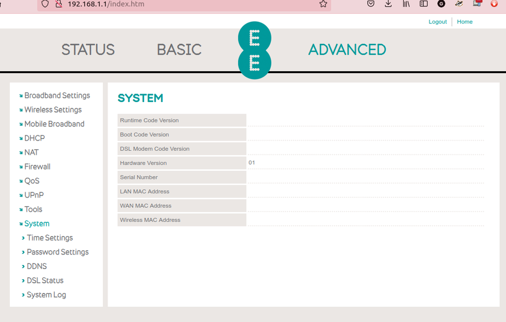

I looked for router details on the system page but all the fields are blank.

It's a Brightbox of some vintage. These screenshots show a) nothing in the dhcp list (even though arp shows 12 devices), b) screen to add an address where I can add a mac but can't add an ip address, and c) system page showing no data.

That BrightBox is either faulty or it needs a Factory Reset.

The STATUS heading on the entry page shows nothing at all. I can't find anything in any detail about the connection. I think my speed was upgraded a while back but the router is the original one. I do recall in the past seeing a complex config statement but there is nothing like that visible now. Given that it seems to know nothing about itself it is remarkable that it still works - I'm using it now!

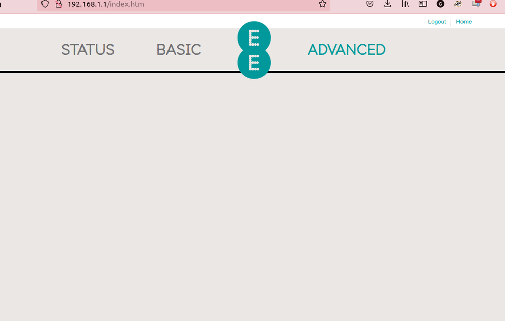

09-11-2023 09:18 AM
This is what I get from the DSL status page: i.e. nothing
