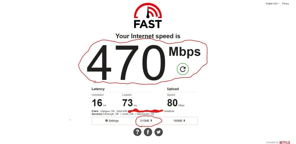

See when approved for viewing, and from Fast.com

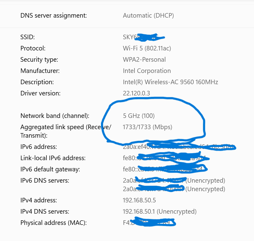

Wifi 5 sync speeds up/downWifi 5 sync speeds up/down
