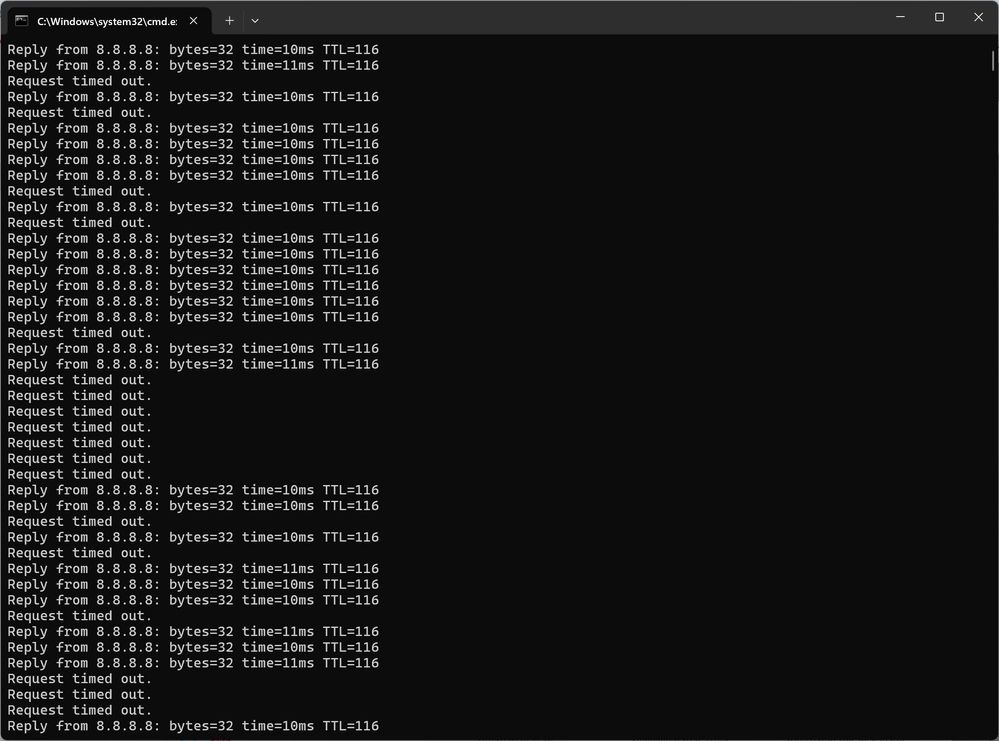

Below is example of my ping tests - if i ping the hub that works 100% with no loss.pings.jpg

You are going about it all the correct way, pinging the hub it's rock solid in response, pinging google is also semi good with a dropped package response looking at you pings but would have preferred if when you do that you have the eero disconnected and just direct single connection on the Ethernet, you can never be 100% sure until you do so, the wireless wifi can butt in and hang the system up as ALL is shared on the connection.
Of course it does! It's got nowt else to do but respond while you're just busy sat just watching it. But pinging elsewhere the target may be busy with its own work to respond to you. Otherwise when it does get through the response time is reasonable.
