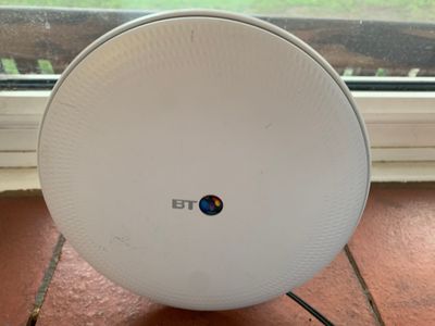

I have the white BT smart Wi-Fi disc and I don’t know what model of EE router I have but I attach photos if that helps. now the BT disc does work when connected to the router with Ethernet but as soon as I disconnect the Ethernet it stops working and I need it to work wirelessly.
If anyone has any solutions it would be greatly appreciated
The router is the EE Smart Router.
The disc would seem to be the white 'high street' BT Whole Home Wi-Fi disc from @bobpullen's description & so should work with each other, setting up as per BT Whole Home Wi-Fi FAQs - Set-up and installation. For 1 variant of which, the Premium, your first disc must be connected to the router using an Ethernet cable, which seems to be the way yours is behaving.
