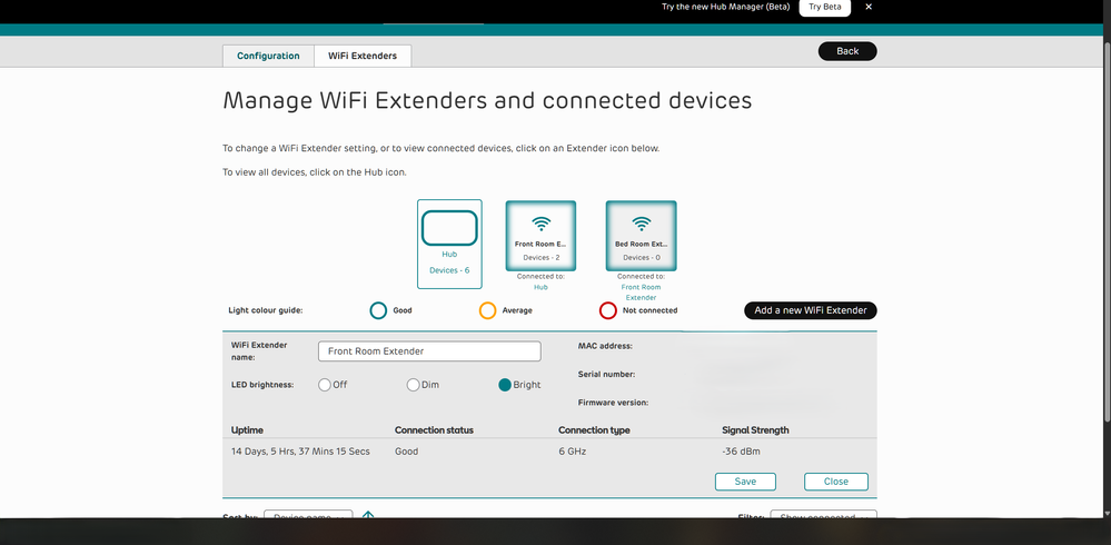

Log in to the router on the internet browser use the address 192.168.1.254 , go the advanced tab , then the wireless tab at the top you'll see a "WIFI Extenders" tab. here you will see all of your WIFI extenders & your hub , what you will find is your extenders are on & in the table at the bottom it will tell you what devices are attached to extender & hub , the issue is in the app for some reason it reports that the extenders are offline when they are infect not  , its always been the same for me too , the app is a bit flaky in this respect , if you can get used to the web interface its much more in depth & a lot more reliable than the app

@SIGHUP , this below is what you are looking for.
