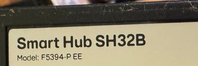

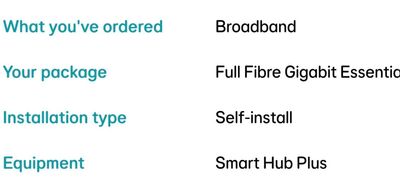

Apologies my new paperwork says Smart Hub+ (plus)
the 2 BT WiFi discs which did work with the previous EE router now won’t work with it
Anyone with this Smart hub plus needs to pay £10 a month more for bespoke EE DISCS
12-08-2025 07:02 AM - edited 12-08-2025 07:03 AM
@Sy8119 If you have the BT Complete Black Wi-Fi disk's then they do not work with any version of the EE Smarthub+, device specific models are require so you need the EE Smart Wireless Plus models, but cable will be way better for sure!
https://ee.co.uk/help/broadband/getting-started/setting-up-smart-wifi

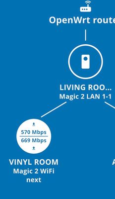

Wherever possible I use Ethernet connections and in addition have noe bought a Devolo Magic 2 which utilises the house wiring as an ethernet connection then WIFI is broadcast from the plug in units Ive found this far better than any other extenders
12-08-2025 06:12 PM
@Sy8119 - those Devolo units/Powerline adapters are fine for lower speeds but once you go beyond 300mbps, you'd be extremely lucky to get anywhere close through the electrical wiring.
12-08-2025 06:30 PM - edited 12-08-2025 06:35 PM
Speed variations occur due to the age of the properties wiring and the distance from the main master unit to the furthest one away
This is the speed I’m currently getting to my music room which is at the end of the property with my living room at the other end . That’s why I opted for a devolo they are a bit pricy but in this case you get what you are paying for but as I said at the beginning it’s all down to the state of the houses wiring which determines any shiort fall BTW my property is 18 years old so not a new build
12-08-2025 06:38 PM
@Sy8119 As long as it is working giving you what is needed that is all the units are required to do!
13-08-2025 11:04 AM
@Sy8119 wrote:This is the speed I’m currently getting to my music room which is at the end of the property with my living room at the other end . That’s why I opted for a devolo they are a bit pricy but in this case you get what you are paying for but as I said at the beginning it’s all down to the state of the houses wiring which determines any shiort fall BTW my property is 18 years old so not a new build
Assume that's the Powerline negotiation rate, rather than the actual throughput (which I'm guessing will be noticeably lower?)
Admittedly lower spec units, but I don't think I've ever seen much north of a few hundred mbps of actual throughput in my environment (5yr old new build). It's been a while though, I've important stuff directly cabled now.
13-08-2025 11:52 AM
@bobpullen Loosing battle that one, 60 year old wiring no doubt and who cares, powerline is what it is!
